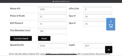

This build is using a Castle MMX8S ESC along with a TP Power 4050CM 2300kv motor. Currently am running a 50T center diff with a mix of silicone plugs and 500k CST. Initial gearing will be a 15T pinion. Front and rear diffs are GP5 15/42 (EDIT make that GP4 EXB diffs) with 500k CST. With this gearing on 8S, I’m look at about 83mph top end.
