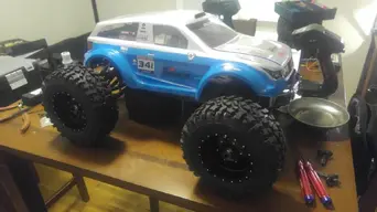

Most true 1/8 bodies will fit. Just try it out before you buy it. This is the proline Baja bug I just did today for my Nero. Love it.
That is bad ass!!!!!! My uncle own a off-road/ baja shop so that is right up my alley. Hahaha!! I was wondering if there was a body like that that would fit!! So getting one!!

I like that the bug is a tad short because it gives it that authentic Baja butt that you see on some real off-road bugs. I have a master plan to create some ducts that channel directly to the ESC and motor and I want the open butt for air flow. It's hard to get the right perspective in a phone pic.

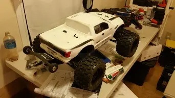

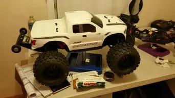

I used the 1/8 2017 Ford Raptor body from Pro-Line and trimmed the fenders to avoid tire rub. My buddy Cr3pitus has the vw bug body (see above
). So far I am super happy, it is much stronger than the original Nero body and looks like my real life truck so that's super cool! One thing I had to do is ditch the rear body posts and put the front ones in the back (since they are a little taller). For the front I used a set from the big rock (which are even taller).
I used the 1/8 2017 Ford Raptor body from Pro-Line and trimmed the fenders to avoid tire rub. My buddy Cr3pitus has the vw bug body (see aboveView attachment 4616 View attachment 4617 View attachment 4618 ). So far I am super happy, it is much stronger than the original Nero body and looks like my real life truck so that's super cool! One thing I had to do is ditch the rear body posts and put the front ones in the back (since they are a little taller). For the front I used a set from the big rock (which are even taller).

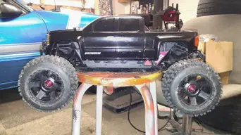

Proline Silverado double cab...this is the body off of my Savage. I'm going to try and stop by the lhs tomorrow. I know they had a few more on the rack...Mike
Got any side shots? I checked the specs on proline for the Silverado double-cab and it listed the wheel-base at 13"...on paper it looks too short, but the pictures looks good. I have also seen shots w/ Savage XL bodies and the NERO looks perfect.
Here's a couple, I haven't gotten to the lhs yet for another one...Mike

Mike,
Thank you for the photos. The body looks very at home on the NERO. Perfect length, width, even body posts in the right location and everything.
