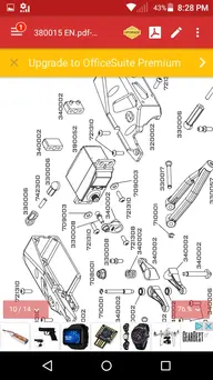

Alright looking for a little help. I have an older Granite. 2013 I believe but not sure. The stock servo crapped out and is discontinued. Tried to email Arrma but their response was to send a copy of the receipt and they would be happy to warranty it. Well no kidding it is out of warranty that's not what I was asking. Anyway I am having clearance problems with every Servo I try including the Savox 230 mentioned above. I see the newer granite's have a removable cover on the servo box like the one above my question is does anyone know if that Servo box can be swapped into my older Granite which has the servo box that splits down the center. I saw I had seen where the newer Granite wheelbase was longer so not sure if anyone knows if it will fit.
I even tried the ads-7 that is in the new Granite
If anyone else has same problem I was able to make it work by grinding a quarter inch off the black mounting blocks on sides. I would still like to know if anyone knows for sure if the new style box will fit the older truck

That is a 2011 model!
The 2013 has a removable lit, as can be seen on one of your attached pictures.
I am not 100% sure, but as far as I know you can swap the 2011 servo box with the 2013 version, which would solve all your problems.
This was next to the bad diff gears the second flaw on the very first edition of Arrma vehicles. Luckily there are almost no other flaws to that ;)
