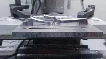

Wish the front center brace had a hold down for the esc wires, I like to machine those into the ones I cut.. so I'll have to 3d print a holder that clips onto the top window rail of the brace.. ill include a picture of the ones I cut... i may also 3d print some protectors for the tops of the towers...for now, zip ties will hold the wires just fine!
Of course I had to get into the camber and toe because i really do not like the way they are setup stock...Build went very smooth, even with the gobbs of red loctite.. :ROFLMAO: I'm sure he will enjoy this rig alot!..

Here is what I came up with for wire retention... simple hinged clip, just clips on the m2c front brace..
Damn a hinged two piece 3D print! I gotta step up my game now.... ?✌?
:ROFLMAO: :ROFLMAO: :ROFLMAO:... got the idea from you brother! Just went a step further with the clipping hinge, keeps them nice and tidy...(y)

That typhon is a real bruiser. Nice work on the wire clip!
It surely is.. should be able to take a beating now.. my buddy is still green in the big air stuff, so hopefully it will take the abuse.. I told him to for sure stock up on diff housings cause that energy is going elsewhere now... I still run the factory towers on my outcast i prefer them because they will give when it matters most..
Thanks for the kind words on the wire clip, it should serve its purpose well, and I love how it's so easy to pull the wires out without marring the insulation...
That wire clip is just simply awesome..!!! ???
