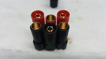

Here is a picture of the connections. Charger, battery, esc left to right.

The plastic connector with the larger diameter is the + positive and uses the male brass connector. The smaller diameter connector is - negative and uses the female brass connector.
