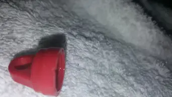

It could've been the cap being just a bit untightened. Could this be the problem? If so, can I just clean it and refill it?
Could it be that little crack right there?

That's a definite maybe.
The problem with the stock Arrma shock caps is that once they get deformed or stripped and pop off once they will likely do it again. Teflon tape on the threads might help. A small drop of superglue to hold the cap on, (but don't use so much you can't get it off again), might work as well.
Try the clean and refill and/or one of the above suggestions first. If that doesn't work you can move on, as others have, to replacement shocks.
