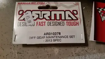

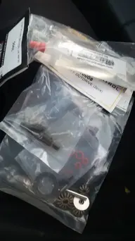

I bought all the parts but the pins won't fit in the out drive cups.....is this a problem they have or do you think I have the wrong out drive cup!
Hi
I'm moving the response from your previse question to here. I hope you don't mind.
Answer: I think you have the wrong out drives, looking at your picture you can see that the number 310008 for the out drives you have are those of the older style out drives. The older outdrives had smaller pin holes.
Arrma Differential OLD vs NEW - The Improvements
http://forum.goforit-rc.com/showthread.php?761-Arrma-Differential-OLD-vs-NEW-The-Improvements
Here are the part numbers for building a updated one.
AR310416 ARRMA Differential Gear Idler Gear Set
AR310378 ARRMA Differential Gear Maintenance Set
AR310399 ARRMA Gear Differential Outdrive
AR310020 ARRMA Gasket Diff Case

I belive I ha E gotten the wrong out drives the hole is way to small..... and also they are not long enough!

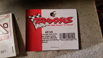

It seems they have made some modification in the differential.... they used Traxxas jato spider gears and outdrives...the also made mods to the smaller gear shafts to allow room for the e-clips on the outdrive
you see here they grinded down the shafts on two sides to allow room for the e-clip on the out drive

The bls is fully compatible to the blx..... this is a mod in my diff......I'm still running the plastic rear end gears the mod is because they had no differ gears available at the time so they used some Traxxas parts!
