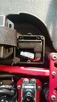

I thought this was interesting on the WP120T. They have the signal cable coming out of the case flush with a pretty good looking gommet providing a seal. Thought Id show ya'll. The factory servo horn went right on the WP120T to the point where I thought It would not work because it was so loose. Once the servo horn screw was tightened down it was all good. On the 170sbl, the factory horn needed to be pushed onto the output shaft of the servo. Its a very tight fit.
Second pick is the SPM 1600 inside the V3 receiver case. The 170sbl yanks the tires around on the kraton with authority!

Looks good. It sounds like no problems with the SPM1600 having enough reserve power to run the high end 170SBL servo in your Kraton? If yes, it's much easier, cheaper & lighter to just get a glitch buster compared to an external BEC or 2S Lipo servo battery. Did you try the Eco Power WP120T in your Typhon without a SPM1600, as curious if you notice any difference with and without the glitch buster, as your WP120T specs are similar to my servo specs. This would be an interesting test and easy to just unplug the SPM1600, if you haven't already tried this?

The 170sbl does great. No problems that I noticed at all.
