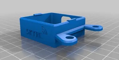

Not sure how many are running the SkyRC GSM020 GPS module but here's a mount for it. I modeled it for the Infraction and guessing it should fit the Limitless too. It might fit other models, it's 40mm from hole to hole so you can check. It's designed to screw down into the body post mount mounts front or rear. It also sits low enough to be flush with the bed when the body is on.

fwiw some nice fellow remixed my SkyRC 020 GPS mount and added a few more options. sweet. :)
https://www.thingiverse.com/thing:4361109
No mounting tabs - Hole in back (tabs can be added to design to suit)
No Mounting tabs - No hole in back (easier mounting via back surface)
Go Pro Clip Mount 1
Go Pro Clip Mount 2 (Same as 1 just rotated 90 degrees)

That's Cool! But I prefer the other one because it's inside the body of my Infraction. But this is cool for other vehicles, but I would but some type of latch system over the top of it so there's no way it can pop out since it's on the outside of the body. I don't think them small tabs that hold it in place, will be good when placing on the outside of the RC Vehicle. One bad bump or crash and that thing is gonna take flight.

those little nibs I put in to hold the GPS in work surprisingly well. I forgot to put a hole on the other side originally so I could pull it out.. end up cutting up the print to get it out. The tolerances are a pretty tight. Even with a hole in back it takes a little force to pop out. I still wouldn't line it up vertically tho.. not that anyone would.

One of my friends had one printed using PLA for his infraction, after taking it out a few times to charge it, he said it doesn't hold it as well as when he first put it in the holder, but it doesn't matter since it's under the body and held down by the body also.

ah yeah.. it wasn't made to remove and it's going to eventually wear those nibs down with how tight everything is.. which is why I made the hole to charge through.

imo probably not.. I thought about making a snap on lid for it but it was already too close to the bed where I mounted it so never bothered. I may go ahead and do it considering people prob mount it up front too.
