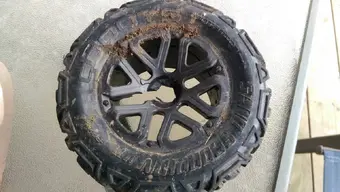

Got my Nero, was pretty impressed with the speed the first day broke the pivot bolt for the cantilever to the shock. I think it was over torqued at the factory, replace that with a 30 millimeter Bolt works just fine day 2 split the whole entire rim and have Good zip ties holding it together till I get a new set of wheels will taking some pretty hard crashes being this is my first big truck other than that pretty happy with it
Welcome to the forum! Thanks for the info. It might be helpful to add another length of extension to the Diff brain servo connections. You have to deal with securing it but I've found that the recommended installation doesn't leave much room for ease of install/removal and no room for wiggle in a hard crash or landing. I added one extension to each and then zip ties to gather up the extra wire. Made my life much easier. I never had a disconnect while driving but I found that some of them were pretty much at maximum extension when installed.
Day three got two other rims split. Apparently the rims don't like to handle high speed cornering on gravel lot and trail. Bobby a backup set of wheels definitely going to get a set of aluminum rims

You had destroyed three rims in-between 3 days!?! How u doing that?
Do you hit the Nero against the wall?
In case of aluminium rims, u will put the introduction to another part and them will not be so flexible than rims of plastic.
Also the hole wheel will become heavier and will give more force to the suspension.

Not hitting any obstacles like walls. Right now the grass is frozen. Just had one shear off completely. Doing high speed corners must be to much and cold weather. Bought some proline trenchers for backup and no installed. Have to see how they hold up being about an inch wider

Probably you're rims are broken depends of the temperature. Mi Wife had also broken their rims an a 1:10 LRP Short course truck.
Just while driving outside with soft touching some wood. It was looking similar than you're damaging.
The Nero BR rims had no issued till yet except some scratches with no effect.

the prolines that I put on a balloon like hell and with three and a half inches wide tread pattern it's so much grip it's impossible to control the car on take off. Now to find a set of rims so I can use the BF Goodrich tires which is a narrower Tire which makes launching more manageable I think the wheel offset is so drastic on the arrma rims that the leverage Factor is hard on the center support. The proline rims are dead center mount
