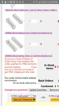

Has anybody tried these optional springs? Want to try them but not sure if I should get the 65 or 75mm ones. Hot Racing also has some. If anyone has experience with those, that feedback would also be much appreciated. Thanks in advance.
I have the gold ones from hot racing. The suspension is still plush, and it does bottom out from
High jumps, but the car stands a little higher and does not squat so much in the rear. I must say my preload is also pretty high, but it works okay. I'm happy with them.
Thanks @Jestone1. If I converted correctly, the 503 gf/mm arrma ones equate to 28.17 lb/in. Someone please correct me if I'm wrong. The gold Hot Racing ones are listed as 21.6. Would that extra stiffness of the optional Arrma ones be helpful you think or do the golds seem to be about right?
I have to say I know only metric/european so I just guess you're right. To tell you the truth I just looked the description up from hot racing and they said it would make it squat a little less. Was all I needed. Would not want my suspension too stiff.
I have the 75mm Arrma springs on my Big Rock, and I like them. Definitely helps with the rear end squat and requires less pre-load to get them just right. Now that I've got them dialed in, I swear the rock flies better in the air too (lot less nose dives than I would get with the stock springs no matter how I adjusted them).
