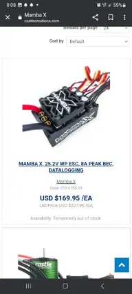

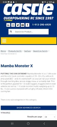

Which mamba x you have??smaller metal one or the mmx6s plastic one???.
The 1/8 x will handle 2650kv fine the 1/10 x may struggle with 2650kv

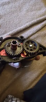

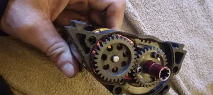

I'd convert to mod1 an swap slipper to spool..
It'll look something like this

Thanks now with a spool setup I can get higher speeds and bash?. I want to not worry about cutting out with the stock spectrum stuff. If that's the case I'd go that route.
With HR spool ya can go as tall as about 29/34 before modifying the power module for more clearance...for good 4s speed you'll want about 2650kv...tp power motors are also a great option an cheaper...

it was gonna be the smaller one
Hell with it,,go with biggest system possible..no heat issues power to go fast an long as ya want.lol...castle escz are a I need more type of thing.ive tried more combos than 1 would ever believe.mm2,mmx6s,mmx8s an now I run xlx2 in detta not because it's the biggest,but because I've maxed out every other esc in vendetta.i now need the xlx2 in all my cars to progress in1 speedrunning.ive currently got ridiculous setup in it an it should keep me speed needs good for a minute..can't really fit a bigger setup in it than I'm currently running.imo the mm2 is 3rd best esc castle makes an imo much more powerful than the mmx6s I've got..
