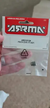

Am I right in saying the speed pinion is a 20tooth buddy ???
Yes 20t. Doesn’t need it, it was fine on 18t but mine came loose and destroyed the grub screw.
Yes it is. The 3S vorteks comes with an 18 tooth pinion installed and an additional 20 tooth pinion which is the speed gear. Stock motor is 3200kv with 100amp ESC. The KV on your motor is a good bit higher so probably an 18 tooth is plenty good enough for you speed pinion. For general off road bashing I suggest a 14t…15t max otherwise you’ll have a lot of issues with heat and some cogging.

Thanks for the heads up buddy it came today 🙂
