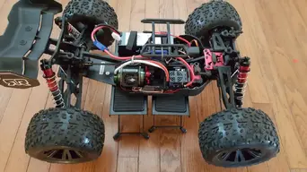

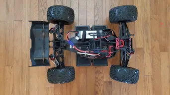

My setup:
  • Fast Eddy bearing kit.
    • No issues after initial 40min run.
  • Mamba Monster with 1515-2200kv motor from an E-MAXX that was always broke.
    • Used one AR723312 (3x12mm cap head) with two AR709003 (3x8x0.5mm) washers for each motor mount screw.
    • The Arrma motor has 4mm cap head screws and mamba requires 3mm.
    • Used 3m velcro to secure ESC
  • 4S2P 6500mah SPC lipo.
  • Futaba R304SB receiver with SBS-01TE motor temp sensor.
  • Tekno yellow springs
    • The stock springs are short and really weak, esp. if adding more motor and battery weight to truck.
  • 14T mod1 pinion
Seems to be pretty good setup. Good temps 55F outside and 85F max on motor.
Might go with Tekno orange springs - the yellow are as low as I would go.
When I fix the shock shaft will put Team Associated 50wt (650cst) stock is (550cst)
- A little heavier oil for the stiffer Tekno springs.
