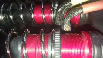

The other day I sent my esc,receiver,and diff brain to arrma. Today while working on truck I found a wire on the motor rubbed through on the shock body. Im pretty sure that ruined the esc so now I have to send motor out. Truck only has ten runs on it not happy.

Thats why some guys had routes the motor cables beside the shocks.
I have done it also on our Neros. Also while moving the upper end of the shocks more to the middle.
After moving the shocks there is enough space to route the cables between shock and side plate.
At least I put an cable tie around cables and plate on one position.

This is why I re-routed my wires. Moved the shocks inward and they were really close to the chock bodies!
