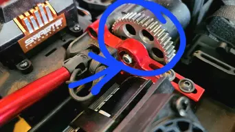

Also how much travel should this Spur gear have on this shaft? It almost moves across the entire smaller (Pinion? Gear)

And yes the side to side play in the spur gear is totally normal.
Mine does the same exact thing. Haven’t had any issues with it.
I would ditch those motor mount screws though as they are notorious for stripping.
