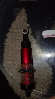

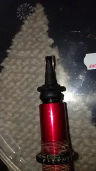

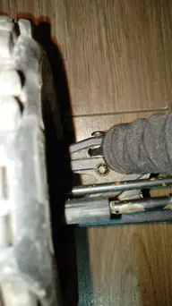

I Brook a right rear rod end on my outcast,it was my third jump of the day i couldn't believe it"WTF".. no available in the UK so I've done a bit of modding....I glued the part where it snapped then i used a dremel to compensate for the extra width of the washer's then I glued the washers to each side of the rod end..hopefully it keeps me doin a bit of light bashing for a while.
