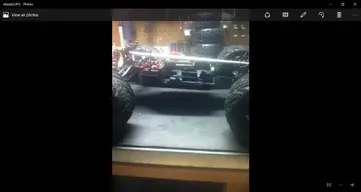

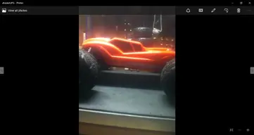

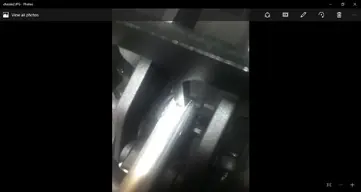

I cobbled this together tonight...it seems like it may do the trick. The aluminum rod is notched in the back and has a hole through it. There is a zip tie around it. In the front....I drilled a small hole in the shock tower and threaded it, then drilled a hole in the front of the aluminum rod. I added a rubber cap just because. Then I screw in through the threaded hole, through the rubber cap and down into the hole in the rod. It wedges the rod in there nice. It all fits under my real low body. The Kraton already feels better with this mod.

That looks pretty good! I was thinking of doing something similar, let us know how it works out. Also, what body do you have there?
Looks like Proline bulldog, but what vehicle is it meant for?

The chassis stiffener is a keeper....The Kraton seems to perform well with it in. The orange Tekno springs are great also...I have the stock weight oil in the shocks and now 200k silicon in the center diff. Also the wheelie bar ...loving it.

I know the 2 shock towers are 15 1/2 inches apart. If you use a big truck body....it's much easier to attach a chassis brace up higher on the towers. But you are already going with a truggy body.

Sweet...sounds good. I got my brace coated with shrink wrap today, looks much better now.

It is 3/8 bar aluminum ....I get it at McMaster Carr online. I think I've seen it at Depot also. I had to use a few zip ties in the rear. If you look close, you see them holding the rod down. I wrapped 2 loose and one through and over the top of the rod.
