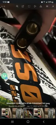

I smell burnt and thought it was the lipo about blow up turns out the cells are good but brown thick substance is coming out of connector it came with please help here some pics .
not even one pass just to run test.
Pic is blurry, hard to tell.. seems your cam focused on your hand.. lol..
Could be flux.. but, it shouldn't be getting hot enough to move flux again.. was it hot when you pulled the connector? That esc side pin fits tightly in the battery plug on that side?
Ya probly didn't plug it in all the way an the anti-spark orangish-brown ring inside the qs8 melted.99% certain that's what happened,happened to me..probly a bunch of it in male connection on charger aslo
Hard to see ,but that ring is the anti-spark ..you need new connecter on pack now
Yup,in your pic can see its melted...I hate qs8 plugs

I was able to clean all that out an still use connector,wouldn't advise on high powered setup.i see ya got mmmx8s so you should be fine if ya clean it all out,xlx2 could possibly get damaged with plug like this,restrictions,starving a xlx2 will damage it little bit at a time till it gos up in smoke,they require big wiring,minimal connecters,an very good sodoring connections or else
QS8 Negative makes contact first. Then the Positive. So the Neg has has the Resistor connected in circuit before the Pos Bullet engages. For anti sparking. If that makes sense. In the pictire the Neg barrel/socket is higher. So it makes contact first. The Pos. barrel/socket is recessed more than the Neg for this reason. How I see it?

Look at the new pics .
That can only be from Excessive flux paste during soldering Which causes corrosion. Flux is an acid. And if not used sparingly doesn't burn up during soldering like it should.

Heat is the only thing that can make that happen... Now that I see it I 100% agree with @K-BASH bash on this.. it's definitely that reddish, brownish, burgundy ish ring that's in the connector...
So this begs the other question I had asked, was it hot when you unplugged it?..
But also another question is raised.. are you sure it was not like that when you received the battery?
I've seen this happen more than a few times on these qs8's when the terminals are over heated right from the solder job... I've seen a couple so damn bad it was pissing out the back, and you couldn't get the cap to clip on...
Weird they would make them with such low glass transition material, especially needing to have 8 gauge wire soldered to them..
Need one hell of a hot iron to get that to take quick enough to get out without meltage..

When mine melted i was charging an didn't plug it all the way in intentionally because pulling them back apart id rip my damn leads out my charger when they came apart.HE-MAN-HURCULES would have a hell of a time pulling apart 2 brand new qs8s.
I bet a trillion dollars his charger leads are the short 8mm bullets like 2nd pic up☝️....those short 8mm bullets don't reach very far into a qs8,just about to that anti-spark spot,weak connection an it gets hot,or only other thing that'll cause this only plugging qs8s half way in so ya can pull um apart easily after charged,like I did.,either way a weak connection caused this while chargeing

This happened last night while testing the new build the battery has been charged once and I’ve been using to set parameters on the esc and rx the started to smell like burnt so I got scare and threw the battery outside on a bucket of dirt lol

no it wasn’t hot that stuff just smell burnt
