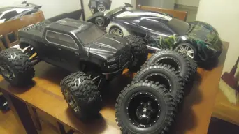

I ordered some Huntsman bead locks and 3.8 pitbull rock beast xl tires that will be going on later this week. But for the record the factory tires are still going strong. It's all the "little" stuff that is really adding up in breakage.
Those wheels and tires look sweet.
Edit... Wow - not cheap though! You heard good things on these?

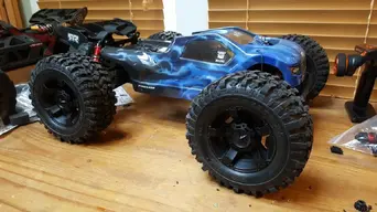

Be careful with those rock beast II. They will not hold up on 6s. I run a set of those on my Kraton on 4s with a blx200 system and 17 tooth pinion and they become pizza cutters at speed. The car almost become uncontrolable. Pretty sure they will blow up on 6s. Just my $.02.
I have been playing around with the diff fluid to try and reduce the ballooning but not really an option on the BR unless you drive with the center diff locked all the time.
