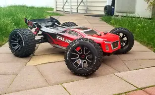

Im piecing together parts for a talion conversion. Has anyone done this and if so anything to note?![]()

Been running my rig at a 1/8 buggy dirt track and wanna run wit dem competition rigs. Lol thanks for your feedback. Yeah i got most parts for the temporary*maybe* conversion just to experiment.![]()
