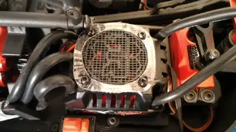

Well, got tired of grass and debris getting caught up in the ESC fan, so decided to try putting a screen on the intake. Have not ran the truck with this yet, I don't think it should cause much of an airflow issue but we will see.
What I did:
What I did:
- Piece of thin lexan, traced the hole and cut out.
- Hot-glued a piece of screen (screen room material from Lowes) on the underside
- Cut perimeter to size and reamed holes for the existing screws.
