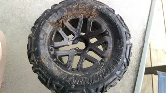

Somehow managed to destroy both rear tires on a single run with my non-diff nero. Not sure if related, but it was my second run on 500k center diff fill and the rear was putting down a lot more power than before so possibly. Both tore in the middle of the tread, enough to cause the foam to come flying out. Anybody else seen this?
Never been happy with these tires so the upside is that Arrma is sending me 2 backflips instead. They were cheaper so I assume that helped in their decision haha. Told them I'd buy 2 for front if they replaced the rear 2. Love them on the Outcast, hopefully will on the Nero too. I know they don't balloon near as bad, so there's that.

Seeing as how that is entirely your fault I would be pretty happy! You will be doing backflips with those backflips.

I wouldn't go so far as to say that it was entirely my fault :D. You mean because of the diff fluid? But yes..very happy and grateful.
Well, running that diff fluid and on 6s... tires don't stand a chance.
Lol yeah I hear ya. All the cool kids are doing it though ;). Less of a diff lock than their actual diff lock though. Maybe the diff-lock version has different tires? It helped the front tires tremendously, at the cost of the rear tires (in my case) haha. Will probably back it off to 200k diff fluid. Especially with the backflip tires.

Yes. The stock tires held up really good for me, the other hand....

Looks like the same damaging like my girlfriend had with their Nero. And she was driven her Nero mostly soft.
With the Big Rock rims no issue till yet.
