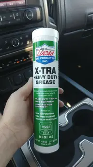

I'm going to try Lucas xtra heavy duty grease.. Meant for high speed and anti sling. Hope it works. Lol

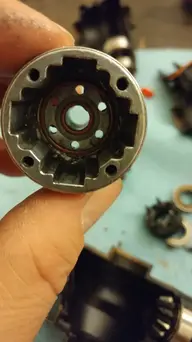

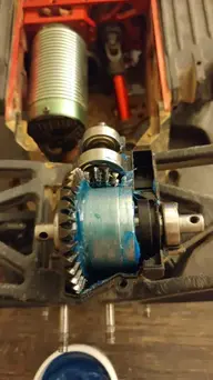

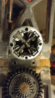

So as previously mentioned, the diffs are indeed grease filled. I did the front and rear yesterday. There isn't much grease on them from the factory so I would recommend changing the grease after a few runs. Here are some pics.
I forgot to take pics with the new grease in the diffs but they rotate so much smoother.
