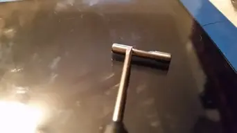

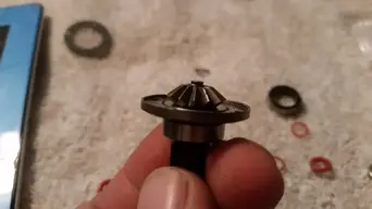

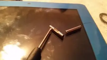

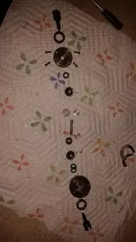

So I bought a Granite BLX second hand. I tore up the differential gears and HD to replace them. When I opened it it was not stock differential! They used Traxxas jato spider gears and out drives and theu also ground down two flat spots on the smaller gear shafts to allow room for the e-clips on the jato outdrives! They also used 20,000 diff oil...... they majority rave 132ft drag race and is apparently an awesome set up for that..... the BLX is extremely fast but not to good for bashing!
20151028_201309.jpg exploded version
20151103_195130.jpg here you can see the spot they grinded out to allow room for the e-clip
20151103_195116.jpg and here again
20151103_195159.jpg here you see the e-clips
20151103_195353.jpg here you can see the gears inside the differential and u have to align the grinded grooves to allow proper room!
