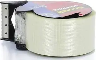

Guys you hAve to try this tape that I got. Combined with Shoo-goo and it's bullet proof. I used the thin syrups of this tape and the "goo" to lengthen the life of my bodies out on the track. The tape is not easy to get it found it at office Depot says you can find at Wal-Mart as well. This is the same as battery tape but at a full 2" wide. Apply couple layers of tape and shoo-goo. I have even used several layers of tape w/o the goo and it holds up. The stickiness is very high and will not come off.
How does the shoe goo mix with the fibers in this tape? Does the shoe goo melt through the plastic?

Does not melt with the fibers, at least not that I can tell. It just toughens it all up. Last repair I did on a cracked body mount hole just added a couple of layers of tape re-drilled the hole for the body post and it's held up great!
