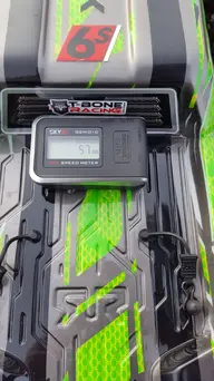

Today I had my nero out and hit 57mph does this seem low for my setup. Im running a leopard 4082 1600kv with 19t on 6s. Lil bummed was hoping for 60s

Doesn't seem low to me.
19T would run upper 60s on stock motor. It runs 44,400 rpm on 6s. The 1600kv motor runs 35,520.
Mite gear up gotta check motor temps a 20t would deff put me in 60s
Ordered a 21t pinion hope it works ok

one more thing to check...
make sure your throttle settings are at 100 percent...those 2 limit buttons on the grip...there is a page on the manual describing the functions...
Got a quick run with the 21t pinion, hit 60 then broke an axle pin. Try again tm but truck pulls the 21t good.
Hit 64 today but the foam inserts all ripped and now everything is off balance

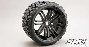

I got a set of belted Sweep Racing wheels. I have not run them yet but balanced, belted seems like the key for speed runs
