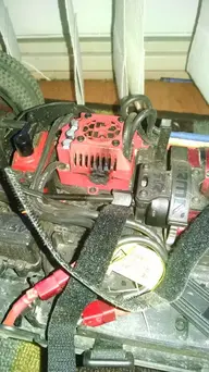

Giving you guys a heads up, I am on my 3rd ESC from arrma on my senton and I have had 2 fail in a way that causes a dead short on the battery. The first ESC that failed this way caused one of the straps on the lipo to fail which stopped further issues. Today the second ESC failed on me when I was trying to figure out the issue with my faulty steering servo. The ESC let out some smoke and shorted the lipo batteries again but this time nothing shorted open so I had the battery catch fire. Just giving a heads up because 2 similar failures indicates this is not a fluke

Yes this is a new level and to have two ESC that fail in the same way is not acceptable. I have contacted arrma and I am waiting for their response. I am lucky that I had a pot I could put over the fire to snuff the fire out. With out the pot I think the fire could have easily set the wood table on fire. Even with the fire being put out in less than 1 minute caused a nice size hole to be burned in the table.

I feel ya. On my fifth battery cycle running 6s my Typhon turned into a Roman candle.......

Did the ESC take out your battery? On my second ESC it took out a strap on the Lipo which stopped the battery from catching on fire also. Was not that lucky on the third ESC. I am hoping that I get a call early tomorrow to resolve this issue

I took the cover off immediately thinking I vented a lipo at first because that was a LOT of smoke and flare.. I was lucky my batteries were safe the ESC connectors soldered themselves to my battery connectors so I had to cut them and solder new Deans connectors on.
