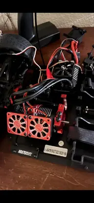

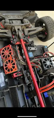

Have the ESC and motor with fans installed along with the new servo. The rest of the parts should be here mid next week.

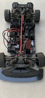

Build update:
The only parts were waiting on.
titanium drive shafts
Carbon fiber side fillers
Titanium motor mount screws
All the fluids have been changed 60k front 500k center and 30k rear. New ceramic bearings. Carbon front splitter. I couldn’t wait to drive it so I’m running the stock drive shafts and a 15T pinion gear. Figured I’d get used to driving before I get to crazy. Cars FAST with the 15T pinion I can’t wait to bump it up to a 20T.
A couple more pictures.

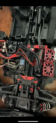

Build update. Scorched earth showed up today.
The side fillers
Titanium rear drive shaft
Titanium motor screw
I’m still running a 15T pinion gear getting comfortable with “drifting” the truck around and learning very small wheel movements.
