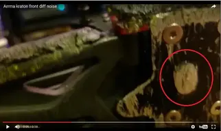

It sounds like the diff gear is hitting the chassis, by any chance has the indentation in the bottom of the chassis been pushed in.
This spot, I've seen it happen a couple of times.
