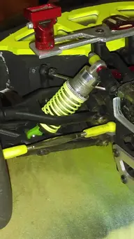

What's up guys! The set of shocks that I found that fits with truly no mod's were the upgrade for the Duratrax ext2 and they come in three different sizes for front and back and is truly how much are you willing to spend! I have my Fury for about two years no problem plus I modified my shocks for a lower ride!
