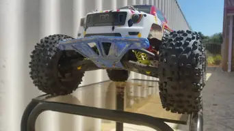

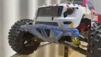

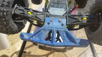

I thought I would dust off my granite and chuck my 3rd body on it today, I went for a red one instead of blue. While I was taking photos of it, I thought I would post up pics of the front bumper for extra bash protection. I use the RPM #81162 bumper for the traxxas rustler/stampede and its only cheap. For the extra protection at the front, its worth every cent as its a wide bumper protecting the front from big hits.
I just had to drill two new holes in the RPM bumper to match the existing ARRMA screw holes that are on the bash plate.
Here are some photos :

I was able to fit the RPM (#81042) with minimal work. For under $6.00 from Tower Hobbies. Two existing mounting screws were almost a match and only needed to elongate slightly to fit. Drilled and tapped a back screw for a little extra support and worked out great into the aluminum body plate. Also needed to cut back two existing plastic mounts slightly for a flush fit to existing front arrma skid plate/bumper.
