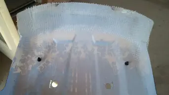

My body was worse than that. Drywall tape and Shoe Goo repaired it to much stronger than new, even with the entire rear almost completely broken off.
I'll have to post a finished picture when I get home. It works great.

Arrma stock bodies are too thin, and way overpriced to replace. Look into swapping for a Proline body. Also, the placement of the rear mount holes is a weakness of the standard Nero. Look at the Fazon and Big Rock, the posts were moved closer to the corners to prevent body flex and cracking.
