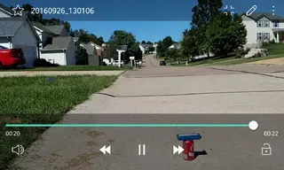

Recently killed off 2 batteries one being a turnigy 3s and the other a onyx 3s. Though my destruction methods are not the proper way and i don't recommend my rookie ways its how i did it. The first battery was the turnigy and i got the bright idea of shooting it with a blow dart. 3 darts later and it caught fire. Bordome and curiosity got the best of me. I then through it in a bucket of water. 2nd battery the onyx was super swollen and had a bad cell not holding voltage and i didnt want to chance discharging it on my charger. Though after trying to balance it twice my charger died shortly after. Maybe i just had bad luck with my keenstone charger. I cut both leads and used a long wooden stick too touch both leads together till they welded themselves together. Kinda dangerous since the battery immediately started to swell. After about 20 seconds they burst into flames and admitted a large toxic plume of gas. Then after it burnt down i soaked it in a bucket of water for days. Im well aware it was bad for the environment and i fully intend to properly dispose of my batteries in the future. Hard to take a still shot in a video on my lg g5 so i apologize for the crappy picture but you can see 1 dart in the battery and nothing happened.
