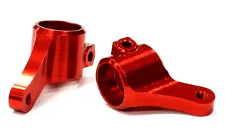

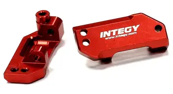

Update: I had and extra plastic pro-line caster block for my Pro2 laying around so I decided to see if it would fit. It fits good, with just a tad of trimming. The Traxxas Slash steering knuckles will be necessary though. I think the Slash design is better, personally. These are knock-offs, but much cheaper.

I have confirmed that the Traxxas Slash 2wd caster blocks and bearing carriers will fit on the Fury. I did have to trim the lower left corner of the block. You could also trim the lower arm as well. Your choice. This is also true for the rear bearing carriers. As you can see, the Fury parts are actually beefier than the Traxxas Slash parts. :cool: Having said that, for those that don't know, Pro-line makes some strong upgrade parts that interchange with the Slash and Pro-line's own truck the Pro2, which kicks butt! Loved mine!
