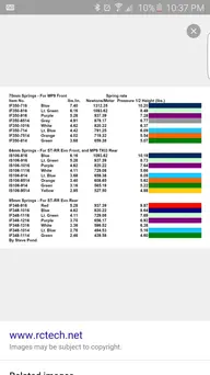

Hey there, yes I also bent my front shock rod.
I changed the fluid to 80 up front and 60 in the back.
Also added Kyosho Blue Shocks front and back (stiffest ones I could find)
This is the perfect setup. I was gapping the triples at the local BMX track and it was flawless.
Google this for the springs.
IF350-716 (front)
Kyosho IF348-1016 (rears)
Here's a shock part list
