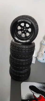

oookay, lemme put these bad boys on and try raise punch settings too
Tyres

an interesting thing happened. Switched over the tarmac tyres, raised punch to 5 and car still didnt want to wheelie. went onto a walk and gave a few bursts and car suddenly started missing power. like when I ate down the diff gears. took it home, something smelled. took the motor apart but it looked good. apart from the slipper clutch started slipping crazy. I tightened it and going for another try. Gosh! Its really time now to get this sorted so I can play with it :D

Yeah, most definitely tighten your slipper. Big wheel setups require it for sure. Listen closely and you can hear when the slipper clutch is slipping too much. You should only hear it for the first few feet under throttle.

So, compared to stock (18T pinion, smaller profile tyres) , I put quite big tyres on too, but it was still doing wheelies well on 18T. But then started doing grass and destroyed the rear diff. Changed pinion gear to 15T, just to check, but it was still broken. Changed out rear giff, filled out with 20k silicone, greased rear diff gears and tried again. But this time the power got caught up in the slipper clutch. I tightened it, but it straight got loose again. Couldnt wheelie on neither the louise rc tarmac tyres or louise rc mt cross . I took it apart now, turned the clutch plates, tightened it and we will see.
Tyres are not too different from the stock big rock or granite tyres, its just they come with 15T pinion by default. So now, if I managed to fix slipper clutch, it should be good, otherwise I gotta buy new clutch plates and it will be fixed. Cant think of anything else in the rear of the car.
