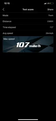

Randomly I decided to take it out for its first official speedrun and it didn’t disappoint. Got a new all time PB of 107mph (172.2kph for those on the metric system) using 27/34 center gearing, 8S LiPo and Perfect Pass set to 7secs. Motor and ESC were still pretty cool to the touch after two back to back passes.
