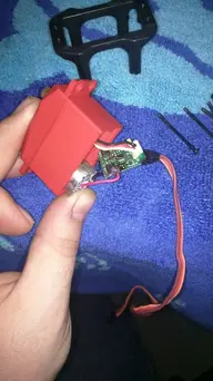

Well I believe it's like @Steve said, the internal bec (which supplies the power for the servo and receiver) on the ESC fried sending way too much power through to the receiver and servo. I attached a picture of the internal servo failure.
ESC sends electricity to power the Rx. The Rx sends electricity to the servo, as commanded by the Tx.
Hence a surge from ESC to Rx, then to servo, a nasty chain reaction.
