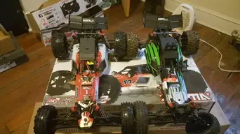

Hey arrma Family.
My own raider xl mega just came in the mail today. Me and my boys all have our own buggy now.
My oldest son 11yrs old has the { green raider blx } that can reach 60mph, me and my other son both have the { red & white mega xl buggy }.
I wanted to have fun but be fair with my boys when we race, so i got me one too.
My question is: My son has the raider blx green buggy with a 7.2 volt 4000 mah pack battery in it, will it still beat my mega buggy thats all stock but has a 2s 4000mah 40c lipo battery ?
Oh and my other son has the stock xl mega with 7.2 volt 5000 mah pack...
Lol, don't mind the arm on the green buggy. I have to replace the shaft because my son got his first crash in...

According to this, if you gear up the Mega and run 2S lipo, you should be close to the stock BLX on nimh. But only if you gear up.

Awesome!!!! Have fun with those cars and most of all your kids. Good times!!!
Those are two nice looking Raiders!!!;)
What's up with the left front suspension arm of the BLX?
