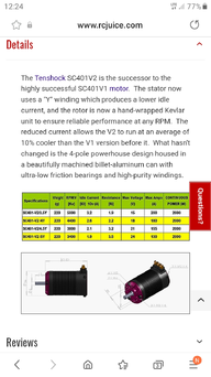

Yup, I found some unbranded max10 sct 120a on ebay for about $70.. was considering combining one of those with a Tenshock 3660 3400kv.. I have a Tenshock 6 pole 2200 in my mojave that has been through the mill. Just keeps on going.. I like to be different, just me..🍻
I'm leaning toward the 3400kv..
