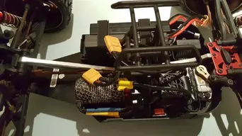

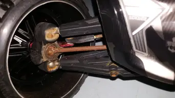

What is the best way to clean my kraton as some parts start to rust!
Does WD40 have effect the parts or i can use it?

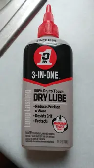

I personally don't like using regular WD-40 as the oily film tends to attract dirt and can really speed up the failure of non sealed bearings, Especially arrmas junky bearings. Any kind of silicone lube does a better job of repelling dirt and will keep the rust at bay and theirs several makers. Wd-40, pb blaster, etc. My latest purchase that im trying is this 3 in 1 product and i expect good results. Ive used my bikes chain lube before which is essentially the same thing. After each run i like to use a cheap paint brush to wipe off the dust/dirt and if it isnt empty i like to use a can of compressed air to at least blow my bearings off.
