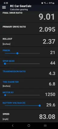

I have a kraton exb 6s with max6 esc and spectrum 1250kv motor I want it geared for off road speed runs.I have a 44t spur gear in it and I'm planning on running 8s mostly on this setup.I just ordered a 28t pinion will the gearing be to much for my setup?I also have dual power hobby twister fans on the motor with stock motor fan mount.only want to run 8s like I said.Also don't worry about my diffs they will be just fine my hole exb is upgraded with vidavon and hot racing all 3 diffs are fully upgraded to aluminum.so please don't tell me about how hard it's going to be on my diffs guys just need to no about gearing will it be to much like I said it's going to be 28/44 thanks to all in advance!!! P.s my lipos are 120c thanks

1250kv on 8S with 28/44 gearing is way too high for off road in a Kraton. That would theoretically put you over 100mph, and I don't think those kinds of speeds will be possible off road with that setup. You would need a bigger motor and ESC and even then you'd run into major problems with tires and controllability.

6S would theoretically put you around 80mph.
If you're good with that speed, then you'd have better luck going after it with 8S since it'll keep amps/current lower. Approximately 22/44 gearing.

I would educate myself on gearing, amps, and voltage to determine a starting point. Then I would work my way up, perhaps starting around 60mph for off road, going up one pinion at a time until my system is too stressed and requires change.

Thanks for your help bud and also thanks to all that helped.im going to be running 20/44 on 8s my kraton is fully upgraded down to the diff gears in it its maxed out with hot racing and vidavon its nothing else to upgrade lol I'm also running titanium drive shafts front back center also titanium piller balls and titanium hing pins oh almost forgot titanium turnbuckles front and back all titanium parts from scorched rc.with the gearing im going with should put me right around 80 mph even though I probably will never go that fast it just fells good knowing I have it in reserve if it's needed to pill off on someone in a close race lol.i want to give dure16 a special shot out thanks for making me hit the drawing board with my gearing and really take the time to study what I'm doing you all been great help and soon as get this running with my gearing I will update this forum thanks to all much love my arrma brothers....ManChildRC-Arrma Nation baby!!!!!Lesh get it🏎💨

U R Geared way too high for off-road IMO. I don't even gear my on-road bashers for 90+. If you are bashing with big wheels in the grass and dirt I would gear down to the 60's to start.
Edit: I don't have an 8s rig yet so my suggestions are based on Arrma 6s Spektrum/
Um no I'm not did you read what I went with ?it's now 20/44 that's not high at all for my sir up sorry dude.
Also that chart is wrong lol for on its 44t spur and 22t pinion also that's not 8s voltage 8s is 29.6 sir give or take a little spike on voltage I'll be right around 79-80 mph we're did you get them number from lol
I'll do mine this way and you do yours your way how about that...BTW 8s is 29.6 your over voltage

Also just bc it reads 80mph do not mean it's going to do that speed even if it did I'm not.this will be good gearing for my rig also keeps Temps down with that gearing...I run 8s not 6s ppl run 22-23 in their 1650 motors on 8s so why would u really think it's to much for a 1250 kv lol

2 mph difference... my calc had 8s selected... we r doing the same thing it would seem other than I chose 3.8v and u chose 3.7v for sag?
