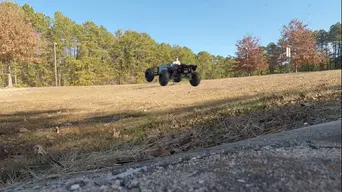

The Badlands are like running a 10 tooth pinion. They keep the Kraton cooler. I'm a huge fan of them. because you can't fit a smaller pinion than 12 if I recal.
To the OP....one thing about Badlands...they make the width wider but I like them. Here are a few pics. I do like the new Back Flips also but they are probably larger in diameter.
