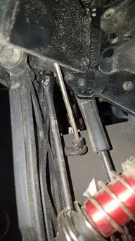

a photo ,the ride height is oké ,thats not the probleem

The steel isn't hard enough is all. That's why some 1/8th's are big bucks and some are not.
