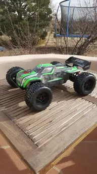

you could turn down the esc punch... or swap out tires. those backflips hook up a lot better than the kratons tires, making it wheelie.
I have Backflips on my Kraton. Why would I want to turn the punch down? It is the nature of a short wheelbase to lift the front easier than a long wheelbase. If you greatly shortened the wheelbase on your YZ the front would come up a lot easier wouldn't it. No one would tell you to just not twist the throttle on your bike as much to keep the front end down.
Just telling TobyJoe one is a stunt machine and one is more of a performance machine, based on essential the second platform.
My personal preference is performance.
I meant to say "based on essentially the same platform".
Your kraton looks awesome with those wheels!
They work so much better than stock kraton tires and the wheels may be my favorite rc wheels ever!
