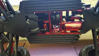

Just waiting on a few parts and I'll report back how it runs.

Its a torque monster, broke two traxxas pins in 5min. Running 6s 6600 lipos and 17t pinion. Think its gotta be geared up or all this torque will break everything. No motor temps yet because it's cold out
