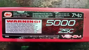

I have a battery that came with my truck I bought second hand. I know for sure it is a 2s 5000mah. I'll get the rest
This is the batter I have that came with the truck when I bought it.... so I hope it good and looking to run the same I guess as I think I can knly run up to 2s in my blx @Dustin Mustangs

Ok, you are not going to need much to charge that one. It says 1c max charge rate times 5 ah (1000mah per ah) means you need, at most, a charger capable of 5 amps. Also make sure it can balance charge 2s.
I don't have any experience with it, but this one seems pretty bad ass for the price and includes everything you would need:
