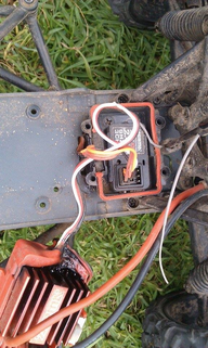

With the mega vehicles id stick with nimh, my esc caught fire within 5 minutes of using a 2s 5000mah lipo haha not fun :(

Normally the MEGA motor will be fried soon on 2S only.
But again this should not happen to the MEGA esc. It is lipo ready. So I would suggest to claim warranty.
