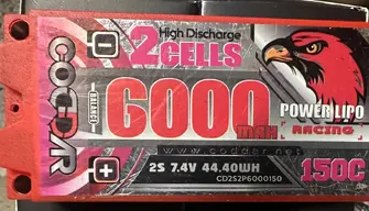

If you want to try a 2s in it.. I have a decent quality CODDAR 6000mAh 150c 2s LiPo I bought in March for $70 that I have no use for. I may have used it once or twice in a granite Grom. But you’re welcome to it for $20 shipped.
